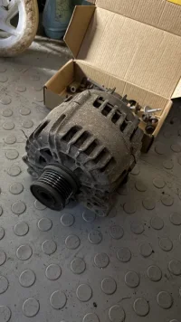

Hope it fixes your problem. Cost me more than £600 at a garage who insisted it was alternator at fault so I had to get a new one. Which after showing them the 'solution' as found on this great Forum, they did find the broken cable , fixed the fault but wouldn't replace the alternator back !!! So as it is, I currently have a perfectly good alternator in my garage ...
