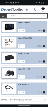

I've specced up an upgrade online, really like the look of the alpine halo, along with the plug and play speaker upgrade.
It's anyone able to advise me if there is anything else I need ref the fitting kit for my 2017 T6, I don't have steering wheel buttons (although planning an upgrade) and have parking sensors.
I've not fitted anything like this for quite some time but assume it's not rocket science!?
