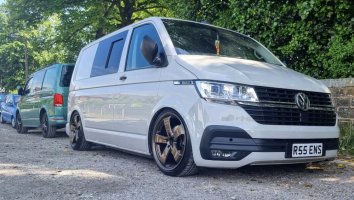

T5.1 but same hardware as T6, running SoLows more or less at full height. Beautiful smooth ride quality. I'm running 20X9 ET42 255/40 with 15mm spacers on the rear. I did find the rear springs a little soft when the camper is fully loaded so I've used a set of Eibach Low's rear springs with no adjuster and it's spot on. My 255/40 are Rainsport 5's are probably a little bigger than other brands in that size.
Lovely looking van mate, and thanks. Its gone into today to check the issue and I'll look at my options. But if its what i suspect then I'm getting SoLows haha
