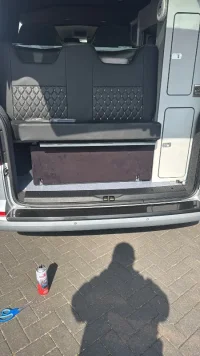

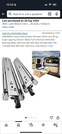

Hi. Love this idea! Are you able to share a bit about how you put this together. Where you sourced the runners from, what kind of fitting you used etc. Did you use self tapping screws directly into the bed frame?

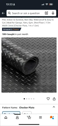

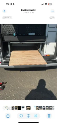

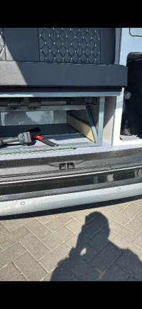

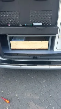

Hi , it’s actually really simple to put together. I basically added timber to the inside of the bed itself with a few bolts to pack it out to the same as the supporting bars (shown in photos) then the runners I just grabbed of Amazon they hold Upto 70kg I think they were around £40. 18mm ply for the base of the draw lined with the rubber shown in the photo attached if you take on this task and need any help just drop me a message it took me about 4/5 hours to complete start to finish.
