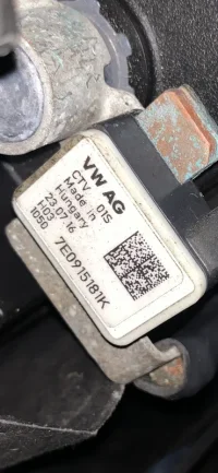

Shunt/battery control module part-no

Wire replaced - it was actually still connected OK, just the sheathing had split, but I refreshed it anyway. Didn’t help with any of my other voltage related issues though.
