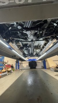

This is my 80L tank on LWB 4Motion. I guess it’s longer at the back. It is right against the ad-blue at the front, it’s not lower, and I don’t think it is wider, but I don’t have a 70L to compare it to.
Having said that, the support straps are recessed into the tank on the right, so maybe it is wider than standard?
