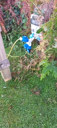

Firstly not my set up but but what are people's opinions safe or dodgy 1 lead to van other to their awning20240917_090544.jpg
That's what splitters are for.
Provided the individual load doesn't exceed the extension cable.(Wound or unwound)
And the combined load doesn't exceed the splitter and the EHU outlet rating then should be good.
EHU outlet could be 6.8.10.12.16A so check the breaker rating.
We always carry a splitter and long cable, as your never know what you will walk into onsite.
Another question in a similar vein - what about running a power lead with 3-pin outlets (as you'd use in a tent) to the awning and then plugging an EHU power cable into that and running that to the van? Safe or not?
When using my awning, I often run a 16A cable from the site EHU to a 16A splitter in my awning and then run a 16A cable from the splitter to the van (and it’s RCD protected circuits) and another 16A cable to our camping RCD protected mains distribution block.
I deem that the safest.
Personally I wouldn't put the splitter into a chassis socket like that, the mechanical stress on the socket is high and you have a strong chance of breaking it (seen that more often than I'd like in marinas)
Much better to put the splitter the other end as @EAN suggests, that also keeps it dry so there is no chance of it sitting in a puddle.
I wouldn't break out from a 13 amp UK socket @Bav and then back to 16 amp. It's not inherently unsafe as the fuse in the 13 amp plug should protect the cable appropriately but it will be a mess of connector and adaptors and the 13 amp ones are not waterproof rated at all. Stick to 16 amp and IP rated connectors to do the "distribution" and only go to 13 amp where you need it.

I’’ve hardwired a split in my EHU cable at the van end. One goes to the van EHU, the other to an IP rated 13 amp socket in the awning (Or tucked away under the van if no awning).
That does mean there is minimal RCD protection on the 13A socket though if you're splitting before the 16A into your EHU, you're reliant on whatever is protecting the cable run at the post.
Hmmm, and the EHU supply at the post is not obliged to include RCD I suspect?

I can see that to prevent overuse it's a simple rule and certainly justified at the head end (mechanical stress and "sharing" with your mate on the next pitch to only pay for one). However if you want power in your awning and your van arguably splitting in the awning on 16A to a tent EHU strip is much safer than dangling a 13A extension lead out of the van.
Personally I'd be happy discreetly doing that in the awning either way as it's how you manage your EHU between a fixed awning and a drive away van - how else would you keep a camping fridge running in your drive away awning?
