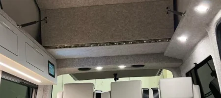

We arent having a wardrobe - just low level units, overhead down the drivers side, and one overhead rear for speakers and reading lights. See photo.
