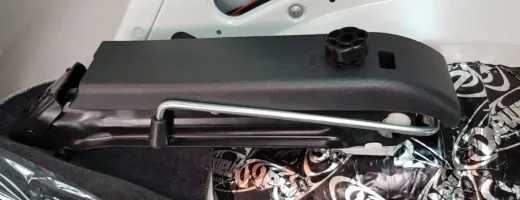

the jack and jack point remain unchanged from the T5 i believe.
so any T5 T5.1 T6 scissor jack should fit.
originally the jack is thumb screwed in the left rear quarter, but as ours was ply lined the jack etc was thrown under the passenger bench as the original location was covered up by the ply lining..
The sticker on the jack from a MY18 T6 panel van.
