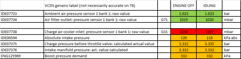

Thanks. The files seem to confirm it's the same issue as previously - G31 charge pressure sender.
The sensor G31 (red) shows weird values compared with other actual sensors (green) around the engine. Normally their values are close to each others both engine off and engine idling. As a consequence some calculated values will also get distorded (orange).
