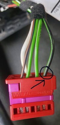

OK. The issue is now SOLVED. But thank you for the guide . . . especially to the terminal block location.
I checked the "A pillar" connection blocks. Confirmed that one wire (black/green) connects to the problem wire at the motor. So, there was NO continuity problem in the shell of the van.
Photos attached for rear wiper connection. (NOTE I did not try tracing the wires for the other 3 pins of the wiper motor connecter plug!)
As it turned out - Fuse access was a problem , solved with a hacksaw - see separate post using the words "fuse access".
The 10A fuse for the rear wiper motor, position number 25, WAS BLOWN - so the auto electric man who said they had checked them all, was basically lying. I replaced the fuse, restored the wiring to standard configuration, and the wiper motor now works as normal.
