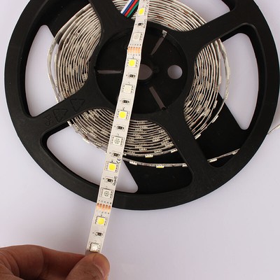

similar to this?

similar to this?

Yeah similar to that although my tape has a single chip with RGBW diodes on it rather than a separate one like the tape you've linked to.
Have a look at my build thread where it's all documented but in short those lights are white only camping lights switched by push button dimmers in the rear door pockets and B pillars. They are also connected to the van courtesy lights so come on white when the doors are opened (this is switched off in camping mode). The door pockets, speaker surrounds, front and rear footwell lights come on red with the courtesy lights. The side channel lights down the roof soffits glow dimly red with the instrument lighting and finally all of the lights are fully RGBW controllable from the switches either side of the van or an app on my phone.
