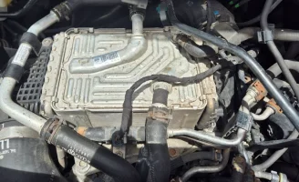

Took it to be a transporter place yesterday and they listened whilst I held the revs to produce the buzz / rattle, they felt it was from under or from the charge cooler, I've looked online and can see most of the charge coolers have a bracket at the front that bolts into the base, mine is loose, its held in by the hoses, I can lift it up about 1cm total or much more if lifting just the front or back, since messing with it ther noise has stopped, drove about 50 miles today and no noise so its pointing at this loose cooler.

Has anyone got an early T6 150 with this shape cooler on to see if yours is loose, it feels like it should be bolted down, pic of of the front where on used ones there appears to be a bracket coming of it, i can lift the circled bit and it will lift as far as the hoses allow.

This is from the top, i think they changed it from 2017, it just sits there being held by the hoses.

I think this being loose is whats causing some of the vibration noise.

Some more googling has found a used one and it seems mines not on this plate very good with the black bung type things
Anyone know if these are replaceable

I have a 150 and my charge cooler is loose as well.
With the bonnet up and facing the engine it can be lifted from the top left corner, or if pushed down it’s metal-on-metal.
I’m temped to pop a piece of rubber in there, but I’m not sure if there’s heat in that area?

Exactly the same as mine, I can see a rubber grommet under there but doesn't seem to be holding the cooler in place, I can move mine sideway a little too.
Your concern on heat is mine too, I want to put something under there just to try it, my luck would be that it dropped out and caught in all the belts!!
Mine seems to be fine when cold so thinking when the rubber heats up its not protecting the metal from touching hence getting the buzzing at specific revs whether still or moving.

It seems these particular coolers were replaced in 2017 with ones that don't have the plate underneath, they just bolt onto the frame that's onto the engine. They must have realised the error of there ways.
Managed to get a rubber door wedge under the cooler tonight, same noise so not the cooler!! Gutted as thought my 7 month ordeal was solved! Genuinely can't think of anything else it can be now, must be something broken off in the back of the dash that is stuck that moves with heat.
