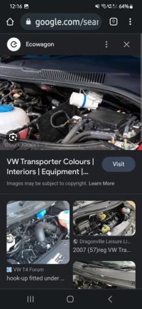

I have this ehu under bonnet and was hiping to get portable solar panel to then plug into this when needed? Hopefully can find a solution...thanks
You’ll have to be more specific, EHU is 240v mains, solar is 12V DC. So unless you’re wanting to see fireworks, we need more info. Or a crystal ball.

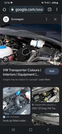

Just posted picture of what I would like to connect to. I'm trying to improve my understanding of electrics....would I need to plug solar into inverter and then plug ehu from van into this? If so any ideas. Much appreciated.
Forget the EHU, it has nothing to do with the solar & never the twain should meet.
The output from the solar goes directly to the leisure battery either directly or via a solar controller, depending on the size of the panel.
