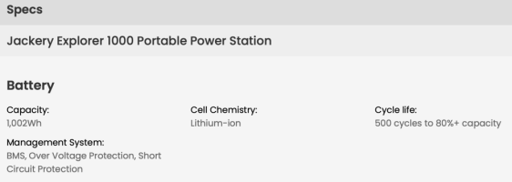

I believe the Jackerys are still using Lithium-ion batteries which have a fraction of the cycle capacity and I think more expensive. Something to be wary of.
Only the Explorer 500 which I didn't consider.

After taking a look I noticed the Jackery Explorer 1000 v2 does use LiFePO4, which is a great improvement — but be careful as other than the v2 in the name its marketed the same. In general, LiFePO4 is the way to go for longevity and safety, so it’s worth prioritising that when choosing.
