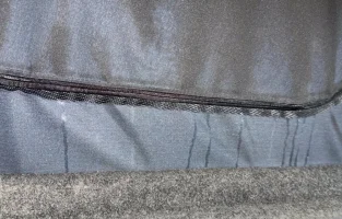

Not sure these will be clear enough - the first pic is the window with the worst leak but it’s also leaked in the front bottom corner driver’s side and the other windows to a lesser extent.
I’ve no prior experience but going by the way it’s made I don’t see how it can’t leak - the mesh on the outside can let rain through onto the canvas & water can just run down & through the zips which are on the inside - or water can just gather on the outer stitching and come in through the zips ¯\_(ツ)_/¯
Ours is like this - mesh outside, zipped panel inside, but it has never leaked.
Because of that I haven’t ever studied the construction close up, but it’s obviously possible to do it without having to suffer leakage.

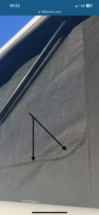

The part that looks wrong to me is the stitching around the outside mesh not sure if it’s clear from the below but it seems water can just collect inside the material above where the stitching is. Is yours like that?

No, looking at the arrows on my above photo there is only single stitching and the 10mm or so of material above the stitches isn’t secured at all. It’s like that all the way round on all of the windows
Oh, I see the problem now. I don’t think mines likes that but I’ll take a look tomorrow and grab a picture.
Here’s some closer pics showing what I think the problem might be but as I said I’m not sure whether it’s normal or not…
The above shows where the stitching is & the loose canvas above the stitching where I think water can collect and seep through
Pulling the canvas back slightly shows the gap more clearly - I’d have expected double stitching as in @Sackmycook ‘s image above?
Both side and front windows are the same all round. Not sure just using fabsil etc would solve this problem?

Sorry, that looks really poor construction. 1 stitched seam, water will pool under that loose bit and get through eventually.
I also don't think the angled mesh helps either. I would think it should all be straight on horizontal and vertical axis
At least the converters are consistent!
+1 for this.
Gravity and physics will always win. Water will always find its way to the lowest possible point by the easiest route. Pooling and seeping through that joint.
