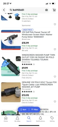

This thin pipe in the pic has snapped off, it is situated behind the inspection panel of the near side arch liner.
does anyone know what it is/does?
twin outlet windscreen washer pump . . . . . . .
get someone to pull the screenwash lever,
Thanks, windscreen wash still works ok but I’ll replace it anyway now I know what it is.
great forum this, cheers again
One side does front and the other does rear (bi directional pump) so maybe the back not working ?
It looks like the spigot has broke off which I think is actually part of the pump
