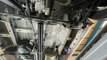

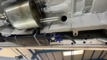

Has anyone got any photos of the back of the sill/underside of the Drivers Side on a Short Wheelbase please.
Looking to see if there are any suitable holes or rubber bungs that go into the inside of the cavity to run a pipe into the van.
Mines got the plastic panels covering that area and unfortunately I’m not the most able bodied person. So don’t fancy removing the panels at the moment.
Thanks
I recently went through this looking to route coax for ham radio antenna. There aren't any such openings in that area.
I had to run a "vent" pipe for my grey water tank. There was a bung under the drivers seat that I used, if that is any help.
There are a series of bungs along the sill of my LWB, including one that comes up in front of the C pillar. There is a gap behind the C pillar to bring it up, which is the route I took for water and waste on mine. I needed a helper poking a cable through underneath whilst I tried to fish it out from above. Got there in the end.
