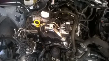

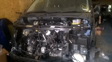

WP_20170323_10_11_37_Pro.jpg Bit of an update 1st picture is as the van arrived. I have removed bonnet, rads, rocker cover and lots of broken plastic. I managed to find a rocker cover on E-bay other parts so far have come from TPS. Old rocker cover was removed which meant taking most of the top part of the engine apart including removing injectors, now all back together. Front and R/H engine mounts have been replaced plus plate on top of L/H engine mount. Slam panel / rad support has been sat in place to see what needs doing to line everything up, O/S inner wing will be replaced. I have bought a complete air filter box, comes complete with a filter, very generous of VW!!! Parts are pretty eye watering and due to the newness of the van not much is coming through secondhand. Next job time permitting is to connect up the rads, turn the engine over and then try for a start. Van has got air con and 2 seats one behind the other in the back mounted on rails. Seats will be coming out to put a bench in the back. Van has also got a wheel chair lift in the back which will be coming out to be sold. Lots to do and no time but will get there. Cheers Baz WP_20170323_10_11_43_Pro.jpg WP_20170323_10_11_57_Pro.jpg WP_20170327_17_25_04_Pro.jpg WP_20170415_14_33_41_Pro.jpg WP_20170428_12_05_18_Pro.jpg WP_20170428_12_05_35_Pro.jpg WP_20170428_12_05_52_Pro.jpg
Hi @BAZT6, I'd consider putting it on a measuring system such as a P188 Blackhawk to check it didn't tweak the drivers chassis leg up, or down when it broke the engine mounts, that way you will save yourself any time later, as any tweaks to get back to OE spec will be straight forward at the moment due to its state of undress.. :thumbsup:

Bit of an update, have had some luck with getting parts for the van at the right price. Headlights from Ginger, rear bench seat from Pats, bonnet and various front end trim parts from Fish. Front bumper from Ebay, London address but tracked via Poland, is Ok though. Getting to know most of the guys in Canterbury TPS as well. Cam belt has been changed as it had a lump out of it from accident. Built the front end back over the last couple of days, turned key and it runs, so reassuring when that happens. Have noticed that rear engine mount has broken, which will mean another trip to TPS. Rear bench seat has been fitted with genuine brackets that came with it. New front bumper support fitted, old one was a bit wonky. Jobs to do inner wing repair, air bags, seat belts and some paint. No mad rush and fitting it in around every thing else. Bits do turn up just have to be patient, this forum has been very good for this project.
