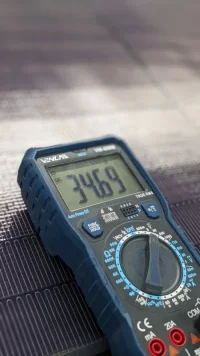

Test the panel by disconnecting the cables to solar regulator, test these 2 cables to see what voltage you have. Heres one of our installs where we tested prior to connection, this was inside workshop....
