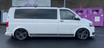

Any pictures of Navis Twin-5 running 255/40? Bonus points if they are silver & Goodyear F1
Thanks for the picture, I already have some but curious to know why nobody fits 255/40/20 104, just trying to gage what they will look like. Currently on 255/35
I Think 265/40 will rub on my van.
We have fitted 255/40(but normally a 275/35/20 the VW recommend size)-normally on t30 or lower in 101 rating- but very little selection available in this T32 rating . The 265 works very well on this size wheel and zero rubbing unless you are going solow low heights.

Might be a bit too long since this was asked but I have 255/40/20 Front 265/40/20 Rear on my Navis Twin 5 on my T5
