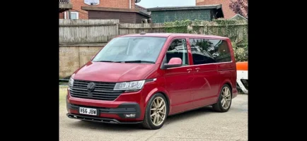

My 6.1
Really nice, stunning colour. I for one would like to know more. That looks the perfect ride height I would be aiming for. Can you tell us more about the suspension. Just springs or shocks & springs. How low is it.
Are a few things I wondered about :)
Transporter hq b14 komfort low could go about 15mm lower but I've got a camper conversion to fit. Ride quality is better then standard.
Ah so a coilover kit I hear the B14 kit is good. Im not dissin your opinion but I guess ride comfort is subjective, although I read its got decent ride quality. Im thinking I wont get away with just fitting lowering springs. And may have to also fit the shocks too.
Definitely, fitting just springs is worse than having the standard suspension and the standard suspension is god awful as it is!
It's either got to be a decent set of springs matched with shocks or a decent coilover set.
And then on top of that the quality of the tyres makes a huge difference too.
I'm on 20" goodyear Eagles and STX coilovers down about 80mm and it's much more comfortable than it ever was on standard suspension and 17s with van tyres.
Exactly what i found
The kit i fitted is actually the B14 komfort low.
I had the B14 kit on my T5.1 it was good but ride quality with the komfort kit is notably better. Not a cheep kit but in my opinion worth the extra
