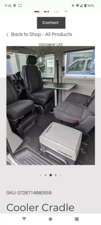

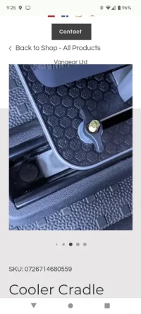

I’m considering something similar for the space where the middle seat would be, I’ve got a 1+1+1 setup. I’ll make it out of ply and use U bolts or J hooks to fix it to the seat brackets.
In my research I came across this table from van gear which might help visualise a possible fixing setup.
@samazon there is a setup with a fridge in one of the photos that might help you.

@PapaJay that’s hugely useful thank you mate, that bracket with the dometic is exactly what I’m after!
