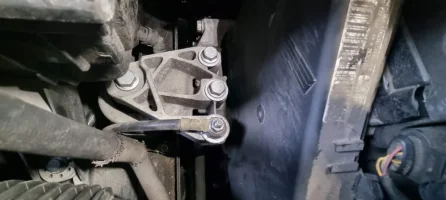

Just passed MOT with a couple advisories, one being: Engine mounting damaged but not to excess lower (6.1.8 (a) (I) .
My question is, what mount is this pointed towards and was wondering if this could also be causing a slight knocking sound ? Driving me made and I'd like to get it fixed.
Cheers
Could relate to any engine mount.
And most likely.
They said the bush on the front mount has perished, not damaged. Just that's the only code they can put through. I'll have it replaced anyway
Cheers
Actually, that's the front upper engine mount.
There is another one at the front of the van at the bottom of the engine.
It's probably that's one?
You can see it at the bottom front, if you look up.
