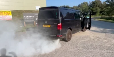

Is your brake fluid level dropping?
Another cause of white smoke with strong smell is brake fluid leaking into the brake booster and then into the engine via the vacuum pump.
I am not sure if it is a known issue on the VW transporters, but certainly well documented for other vehicles.
