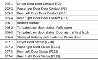

Control Units > Central Electrics (09) > Live data >
Channel 5 = Door contact switches,​
Channel 6 = Bonnet, Tailgate/Barn Door switches, Lock/Unlock switch in driver door​
Channel 7 = Door statuses (locked, unlocked, safe)​
However, as usually you'd like to test these ignition off, the trick with OBDeleven is NOT to click Connect but instead to go directly (as above) to Control Units. It will take a while to establish the communication...
