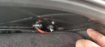

If I recall right, Dellmassive suggested I add a large fuse at the point the live comes off the vehicle battery. How are you getting the live from the vehicle batt to the leisure batt? I took out the plate behind the vehicle battery, unscrew the bolt in the vent (LHS above the vet batt, in through the vent) and on the wing next to the bonnet hinge. Then in the plate I drilled a hole and pushed in a large diameter plastic grommet to stop the metal edge cutting into the live cable's insulation, see image below. I then pushed the live through a hole and rubber seal, which brings the live out under the glove compartment and down the passenger side from wheel arch. I'll see if I can get a couple of pictures.
Coming from top to bottom in this image.
Here you see the rubber water guard at the back of the engine bay. Then the plate with two grommets in (white is EHU and red is meh batt live), then the cloth looking material is the battery cover/insulation.

I saw it when I was watching a Aussie DIY convertor on Youtube fitting the cabling. Others have suggested using the rubber grommet hole on the left of the batter, over the small wall in the main engine bay, low down on the fire wall near where the AC & files lines etc go. But this was simple and apart from having to drill and file a large hole for the plastic grommet it left a neat job, and the live comes out next to the passenger seat.
