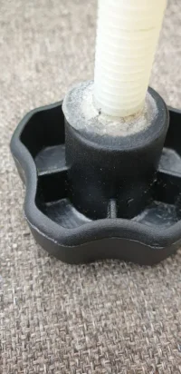

So got the bolt out and though difficult to see in the photo the end of the thread is very damaged. Also no way to remove the bar from the screw knob. Can find replacement knobs for a few quid but all from China so going to be 4 weeks before I see them. Can get 500mm length of bar for £8 from the UK though. Now not sure if I should just buy them ready made from HiLo??
Just an update on this. Managed to drill out the old nylon rod from the knob without damaging the threads. Ordered some new 10mm 1.5 rod and cut to size. Glued in with resin and replaced. Did both fronts, the rod un-screwed out the front drivers side so nice and easy. Ordered 1m of rod so going to order some knobs and make up a spare set. Did check the rears and the threads look fine on those. Might be worth you all checking for thread damaged next time you have the roof up.
