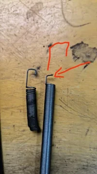

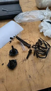

The Volkswagen Multivan T5 sunshade had two problems: first, it wouldn't retract after being pulled out. Second, the black fabric was contaminated with large patches of white stains that couldn't be cleaned. Both issues were caused by water ingress from the sliding window. I replaced the curtain fabric with one that has a higher shading rate and replaced the aluminum roller shutter shaft.
