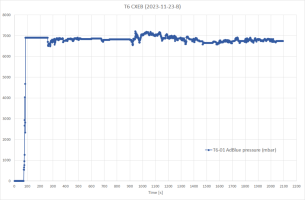

The "IDE10241 - Reducing agent pump module relative press" was referring to measurement values in VCDS - to have a closer look to verify that there is at least some pressure build up. The pressure should rise in a few minutes to 6...7 bars.
VCDS > Engine > Advanced measurement values > Select: IDE10241 - Reducing agent pump module relative press
Then engine running monitor (or make a log) the pressure.
After many minutes with nothing, staying on the parking, I had to drive few Km to see the pressure coming.
Thanks !
Reactions: mmi
So basically working correctly - perhaps? Perhaps you could turn logging on and do a bit more driving to see if there are any noticeable drop-outs in the pressure?
