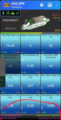

Whats the van spec?
Vag DPF and other tools can get the hw/sw
Info.
@mmi may have some other info on sw versions?

It`s a 2018 T6 T32 SWB Highline Kombi (does that help)
That app looks to relate to DPF. I'm looking at the van in general, software updates
That still looks like it shows current software version etc but not if any new or outstanding updates are available for the van. I`ll speak with VW. cheers
Yes as above the circled details the engine ECU firmware version.
There is a more recent firmware version number that Volkswagen have for this engine that deals with AdBlue issues.
My van has s only ever been serviced with Volkswagen and so far they haven't applied the updated firmware.
Which for me is a good thing as the newer firmware uses twice the amount of ad blue, so I'm more than happy to have my van stay on its current version.
VW will check for any outstanding updates when the van's in with them, you can also specifically ask them if there's any outstanding updates for your VIN number.
In my experience having the latest firmware version is not necessarily a good thing... Not just on these vans but in life in general.

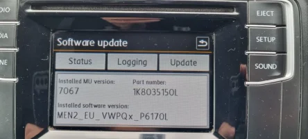

Hi @Dellmassive, i have had a P20ee & Add blue mileage drop then reset issue today. would you be able to tell me if there are any software updates for my 2016 T6 t30 150bhp. The infotainment system shows details as pictured.20250803_143244.webp
Hi @Dellmassive, i have had a P20ee & Add blue mileage drop then reset issue today. would you be able to tell there are any software updates for my 2016 T6 t30 150bhp. The infotainment system shows details as pictured.View attachment 298187
Isn't that the radio info?
I'm very new to this T6 thing & having a mare with one we have bought, just had message from dealer so hopefully they can get adblue error & updates sorted before the end of the month France trip.
Thanks
