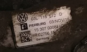

can i identify a faulty EGR cooler from the outside?
Look down in engine bay - by oil filter you'll see EGR cooler sticker - 03L 115 512 D - revision "D" is the updated version. The infamous ones were engines installed with revisions A, B, C - up to August 2015.

I have been reading some horror stories about the T5 and T6 CFCA engines caused by badly designed EGR coolers causing the engine to fail at 60,000 miles .. can i identify a faulty EGR cooler from the outside?
You can safely say that it is faulty, even the Rev D EGR unit didn’t fix the issue.
