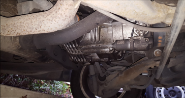

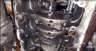

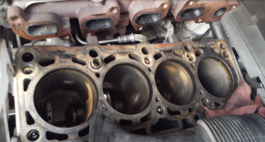

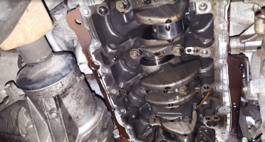

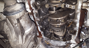

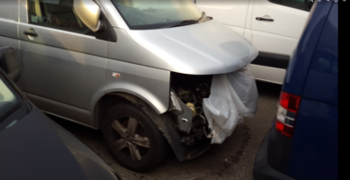

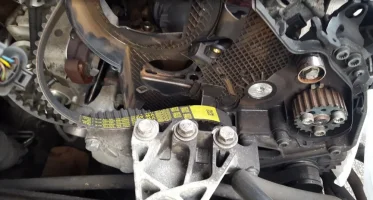

this is my poor T5,1 laid up in the VW Loughton Carpark. . . . Feb 2016
theuy done a proper number on it. . . . it was over the xmas/new year break,
1st mechanic started the basic service, went went home sick. (prob hung over)
then second mechanic contuniued the following day ( again prob hung over)
the story goes the first guy done the oil change, but the second guy just added another 7.5L of oil !!
so it had twice the amount in it. . . . started the engine and raised the van on the ramps to check for leaks or whatever. . . the next minuite all hell breaks loose with a runaway engine.
final result was two bent conrods, snapped cam rockers, chipped camshaft, oil soaked cat & dpf. etc etc etc .
it took me months to battel with them . . in fairness i got to keep the new load van for the duration.
bit it took 5months to sort - as the garage wouldnt accept liability lol.
VW CV didnt want to know as it wasnt a warrenty failure - they said the garage had to pay.
so ended up in a battle with the garage to get it done. . .
the finally fitted a short block engine and cat+DPF and refitted all my ancillerys.
but just done the job in mechanics spare time instead of a booked job.
never got any paperwork or any official recognition that it ever happened. . . . they tried to just sweep it under the carpet.
that van was an 2011 plate, and this happend late 2015, so it was 5/6yrs old with about 90k on the clock.
and yep - that van was a 4Motion, DSG aswell.
its still going now with its new owners - but has a private plate on it so i cant trace the MOT history.
