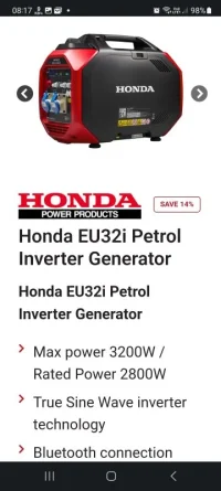

Have people seen the new Honda EU32i....
Honda EU32i | Inverter Generator | Hampshire Generators
Honda EU32i Petrol Inverter Generator is the most sought after 3200W generator on the market known for its reliability robustness with Bluetooth connectionwww.hampshiregenerators.co.uk
Standard procedure in rural Devon, my biggest worry is law and order breaking down and somebody looting my beetroot from the garden!Yes indeed, I’ve got a new Honda 22i Ready, just waiting the the Electrician to wire up a change over switch in the garage so we can run our boiler, we are on heating oil, so only need about 700 watts to fire up the boiler to fill the hot water tank, mainly so we can have a hot shower.. got a mountain of wood and coal for the stove , oh and about 6 weeks supply of food, just for insurance purposes
