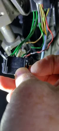

@Dellmassive - you may not remember but this van was one I converted from a full wav vehicle nearly four years ago with a lot of support from you guys. The throttle had been adapted to hand control which when I removed, necessitated cutting and re soldering the six wires to the throttle sensor in the foot well - I'm hoping it's one of those. I'll check and advise
Took out the lower dash trim today to check throttle wiring. Cut back the heat shrink where id re joined the wires and my joints, although not pretty were intact. Had to de solder them to fit new heat shrink and all back together and working ok. After my jiggling the cable and plug on Wednesday in the peaks it's behaved itself - I'm hoping the plug wasn't fully clicked home - fingers crossed IMG_20251017_105420188_HDR.webp
