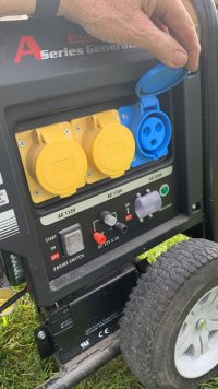

I then lifted the blue cover over the 230v coupler only to find it had a 3 circular pin plug. Next to it were two yellow 115v couplers that also had similar couplers although the orientation was different of the larger pin.
I went and found a Defender 2 gang lead and also a 25 metre extension lead. Both these fit together nicely but neither is large enough to fit to the generator.
Thank goodness we have not had an emergency since 2015 !!!
So I can determine what we need - can anyone suggest if I need new cables or something like an adapter to bridge the larger size from the generator to the smaller size of the lead?

I have just zoomed in on the writing on my image and yes, you are correct.
I seem to recall the blue cable did say 16 amp on it too.

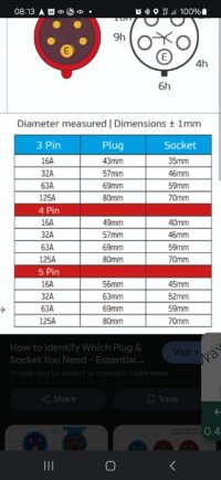

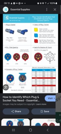

You need to measure the socket width.
It's midday likely a 32A commando.
But could be a 16A commando.

Yep that will be a 32A blue Commando type - you can buy off the shelf splitters that break it down into two 16A sizes (as used in EHU)
Be very careful though that the socket is still capable of supplying the full power, Commando sockets have no fusing or other current protection, so theoretically if you step down to a 16A lead you could draw 32A through it.
If you are using it to power a single power tool for this job you'll be fine.
But if you are thinking about using it some more for events or actually as a backup generator you'll need to be more careful, usually in this role you'd have a 32A rated cable into a board with a number of more useful sockets (likely 13A for backups) possibly via a garage consumer unit with some MCBs.
Okay. Measuring the output plug and using that Essential Supplies site is a solid plan.

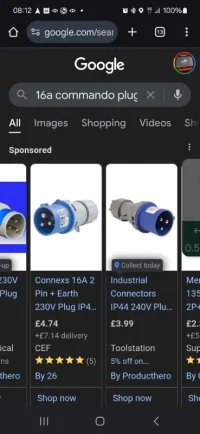

Something like this from Toughleads:

Is it this one?
In which case it has 2 x 110v 32A and 1 x 240v 32A and a continuous load of 6000kVA and a surge starting load of 8000kVA
