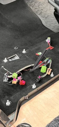

Yes it does. Yeah it’s a good idea. The bench seat has two for the seat belts and two others which seem to go to the seat pads?? I’ll post a pic

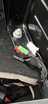

These are the cables I had to disconnect to take seat out. Didn’t turn ignition on whilst disconnected. The only four not connected are on pic above.
The black & white plugs are for the seat belts. Not sure what the red & green are for??
For T6.1 double seat:
Red (2 wires) - seat occupied sensor
Green (2 wires) - pressure sensor for seat occupied recognition
For details see below sheet No. 17/7 on linked wiring diagram (EDIT: 17/5 )
