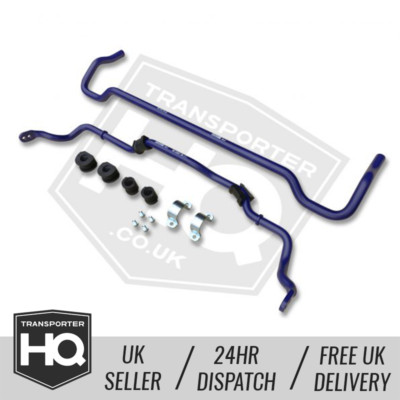

Hi folks, bought some ARBs from Transporter HQ, I thought I'd ordered them for my T6.1... Anyway, my man fitted the rear ARB but the front ARB was an issue, the rubber bush was too small to use the existing bracket onto.
I spoke to THQ who told me I'd ordered them for a T5.
Well the rear DID fit okay, and it drives well, however the front ARB didn't fit due to the bush issue.
Can anyone tell me if the bush size is the only difference on the front ARB and if so, can I obtain the correct, larger rubber bushes? (or small diameter bracket to hold the smaller bushes).
Thanks, here's a couple of pics to muse at!

Thanks, that's a good idea, I will give them a call :)
I was hoping to find out whether the actual bars are the same shape etc, the bushes might be easier and certainly cheaper to acquire!
No they are different to a T6 for the front bar, also power flex to my knowledge don't make a bush for these as the H&R bars come with Polybushes
Might be worth a call. The H&R front arb is 26mm diameter. They have a bush with that ID in their black series, just not sure about the external measurements.

The front ARB on a T6.1 is much thicker than a T5 , its the electric steering causing the changes , they are not interchangeable and it isnt a Bush problem so dont waste time trying powerflex to sort this out
You have the wrong bar , if THQ cant sort it call us we will help rectify this
