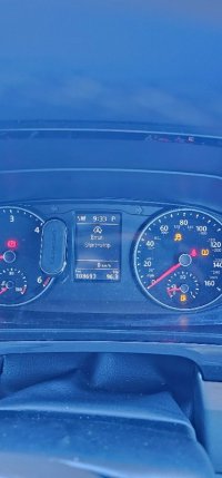

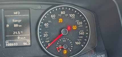

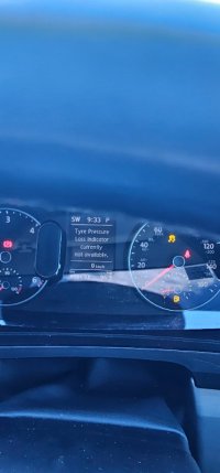

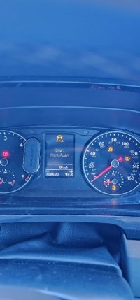

I have a 2017 T32 auto that's giving me some electrical issues and wondering if any of you have had similar?
As per the attached photos I have warnings for front assist not working. Start stop not working, ABS light has come on and strangely tyre pressure sensor not found (even though it's never had internal sensors. Just the ABS system). Now if the ABS system isn't working I get the tyre sensor issue however all these things at once must be connected.
