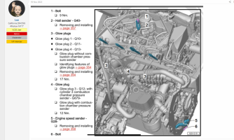

glow plug 3 is the special one with "combustion chamber pressure sensor"

see @Loz pic above . . .
