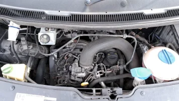

Hmmm, so am I ordering glow plugs for a T6 or a 5.1? Here's my engine

That looks very different to my CXGB.
The engine looks in line - is it rear wheel drive?

It's a T5.1 engine,
In a T6 chassis.
One of the very early T6 vans that rolled off the production line..... Still using the Euro5 T5.1 engine.
So for your glow plugs, as @mmi shows above.
It's the T5.1 engine glow plugs.
And look on YT for the T5.1 CAAB glowplug change.
