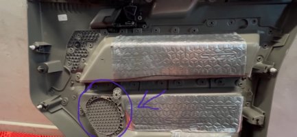

I think I know why…. Could be wrong but it looks like the plastic needs trimming off the inside of the door card shown in picture.
Shown on the link
I’ll take the cards back off tomorrow and see
If it's a T6.1 have you tried trimming the lip around the back of the grill on the door card that's been known to interfere on some speakers. Sound deadening mat alone isnt enough to stop the doors vibration that's why we do multiple layers and use different products as they all have different qualities
