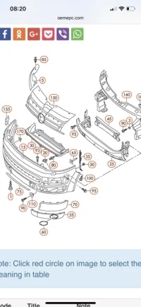

Dear all,
Just posting this so perhaps someone in the future can get some help with an annoying rattle in the front of my T6. From about 35mph after there would be this loud rattle / drone / humm coming from behind the dash seemingly in the engine bay. It sounded just like the noise the heat sheild at the back of the bulk head would make if loose.
Any how after getting the leaf blower on the front end, there is, directly behind the reg plate a large polystyrene part (no 45) on the image, that sits it rather inadequate pockets on the back of the bumper. At speed this is shaking and making the lower bumper resonate.
Couple of screws hidden behind the rego, and some mastic and it's secured again, with no problems so far.
Hope this post helps someone as I couldn't find anyone with a rattle such as this!

I’ve got the same issue, just by chance I was outside in the recent windy weather and heard it from the outside! Great solution using the blower! Anyway, thank god I can fix it before I sell her….typical.
