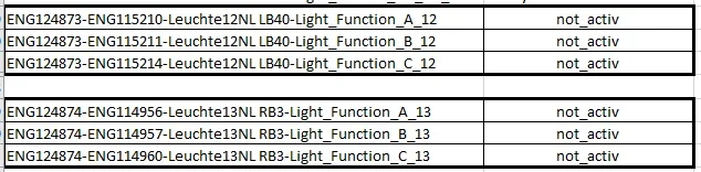

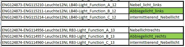

I have a T5.1 Caravelle and have facelifted the car to T6. I’ve opted to lose the front fog lights as I prefer the look and didn’t want to change the windscreen washer reservoir.
I now have 03428 and 03429 errors as the fogs aren’t plugged in. I’ve tried long coding them out but can’t get it to play ball! Does anyone have any pointers or examples of coding? TIA
