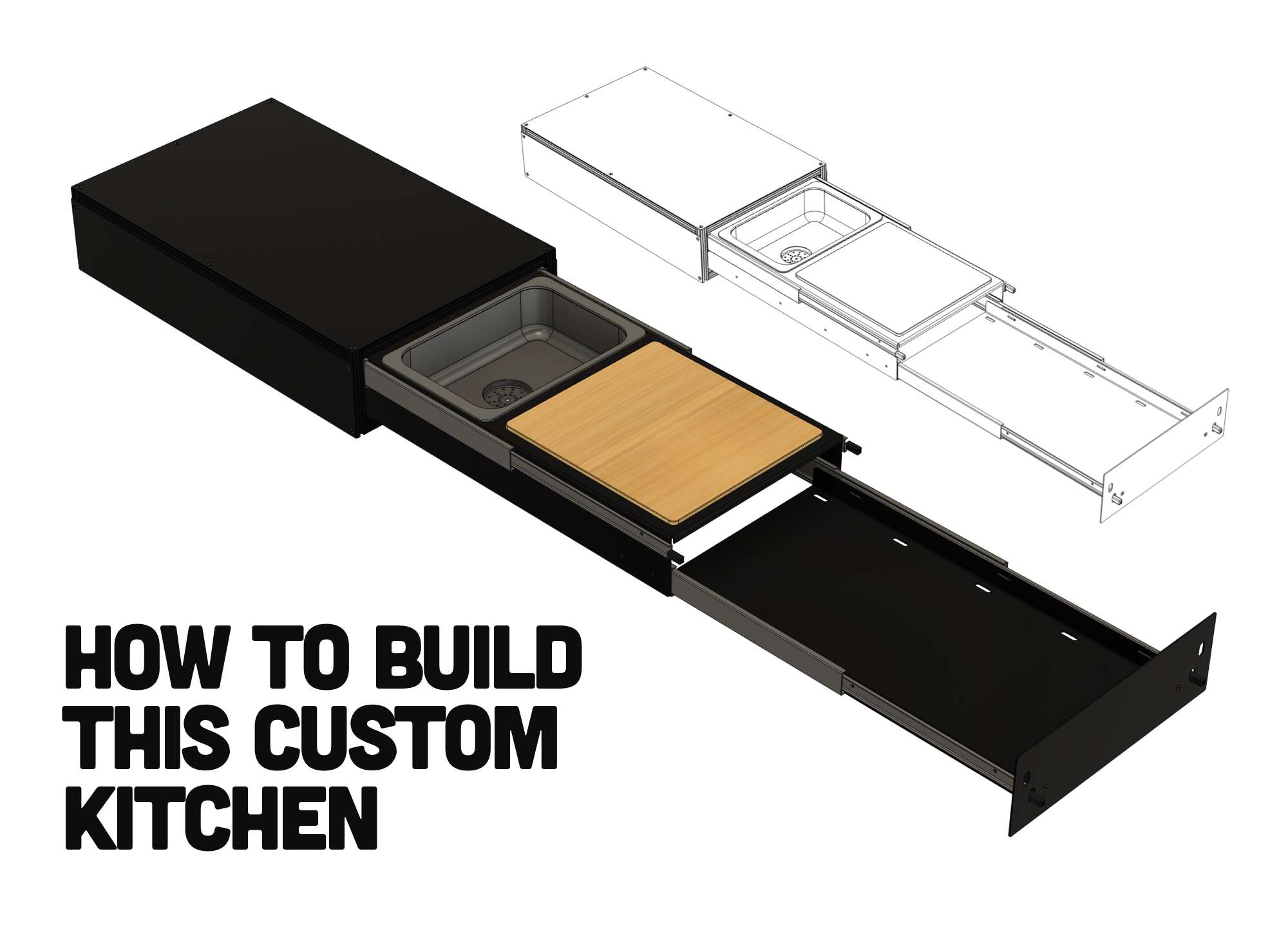

Both suggestions are great, thank you! I also found this, which I thought was very clever:

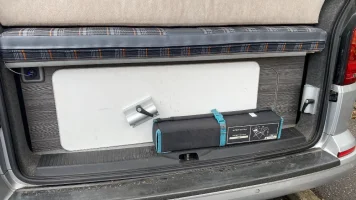

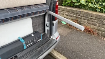

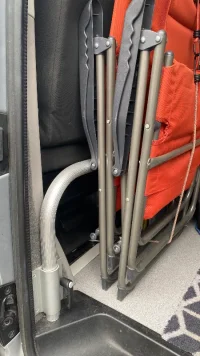

@mattrad hope these pictures explain things.
The first pic shows the leg in its original/storage position with the bracket.
I have a duplicate bracket in the rear of the van as shown in the pics and I just take the leg to the back of the van. You can see the table top stored in the rear of the van showing the table bracket that the leg slides into. As this allows the leg to rotate it means you can always level the table top.

The leg in question that I use is the ‘cranked leg ‘ and extra bracket.
