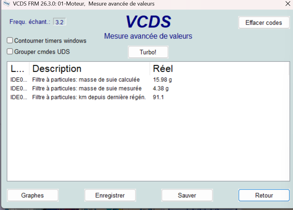

Hello,
After purchasing a VCDS, I just ran my first auto-scan. I should note that the engine was off and the van hadn’t been moved for over 12:00.
I know that many of you own this diagnostic tool, so I’d like to hear your analysis by sharing this initial report (the report is in French...).
I also took the opportunity to check the DPF soot level after the last regeneration.
Thank you very much for your analysis and advice!

Just a quick note: after measuring the voltage directly at the battery with a voltmeter, I got a reading of 12.39 V.
