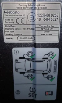

Also I had looked for the heater plate and hadn't found it on the B pillar.
So, anyway, as you're all having a good chuckle at my expense tonight I decided to walk up to the van, where I found as expected no sticker on the B pillar:
And then I thought a bit and realised every one says on the DOOR so I looked the other way and found these stickers I have never seen in 2 and half years of washing, waxing and detailing this massive lump of vehicle:
So now I feel like a complete idiot :rofl:

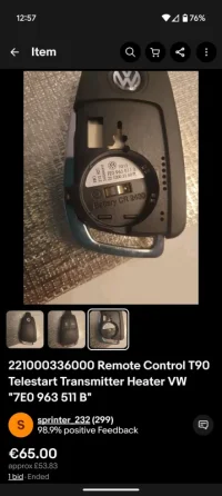

Thought I'd found a remote on eBay but it looks like although the listing said the seller would send to Europe, it actually means EU. So I may not get it. Apparently the EU and Europe are the same thing... :mad:

I've got a B revision remote on the way from Germany (via another member on here who's going to bring it back for me), for £60 plus UK postage.
Should have it next week so I'll update if and when I've been able to pair the new remote!
