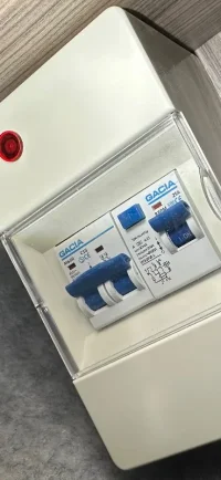

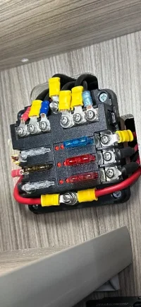

All sounds very odd. The only thing I can think of is that the ehu is causing some sort of voltage spike or maybe bringing in an ac feed of some sort. Loads of photos of your setup might help.

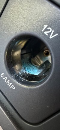

Tried to test the socket voltage and in doing so the 10A fuse blew. It was the oxidised socket in the pics. That was the socket that, I think, blew the cooler. ‘Dampness’ and n the socket…
That corroded socket would definitely cause problems - over heating etc although I would be surprised if it immediately blew a charger. When you say it blew a 10a fuse I assume you mean on the 12v side not the mains!
Yes the 12v side. I have the option to take it back to the ‘shop’ as it’s still under warranty. I should take advantage, it’s just blimmin’ miles away! Thanks for your thoughts.

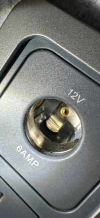

Hi all. Took the vehicle back to source… The installers had wired one of the 12v sockets the wrong way round. That was the socket that blew the cooler and the USB chargers. In addition but not related, the other 12v socket had a hair line ‘crack’ in the fuse. Not enough to tell me it had gone and was still able to fuel a lead light but not anything else. Anyway, all fixed.
