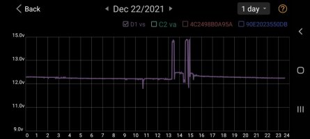

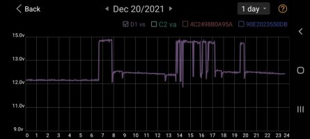

For reference here are some BM-2 plots for my Starter battery (using the BM3 app)
24 HR slice over various days.
Note my Starter battery drops to a resting voltage of 12.2v.... which is normal for my van. 75Ah Varta AGM. 3.5yrs old.
Screenshot_20220104-090055_Multi-Batt Mon.jpgScreenshot_20220104-090051_Multi-Batt Mon.jpgScreenshot_20220104-090047_Multi-Batt Mon.jpgScreenshot_20220104-090055_Multi-Batt Mon.jpgScreenshot_20220104-090051_Multi-Batt Mon.jpgScreenshot_20220104-090047_Multi-Batt Mon.jpg

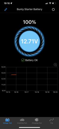

This morning i opened the drivers door, attached Carista to run a scan (didn’t start it) and I got this3CF4DBAA-60DC-4D94-9025-E4E48C6FBB2D.png
that looks ok to me . . 12.7 to 12.6 volts over 12hr period.
its not dropping while parked up. . . . ( to indicate a massive problem )
The blip at 10am will be you playing with Carista etc as you unlocked the van and powered up the modules.
all looks normal.
and shows a good health starter battery voltage . . . much better than mine at 12.2v over night.
now go for a drive and post the BM2 plot later. ( it will show whats going on when the engine is running )
