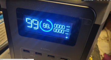

ill do a test with mine here.
ill fully charge it,
then leave inverter ON for 24hrs, and see what happens..
88% now so ill charge and test.
edit:
fully charged.
FW updated completed,
new APP vsn installed. ( the power flow front screen is 100% copy of the Bluetti screen - i dont like it, but you can swap back to the normal screen )
shows 100% AC OFF - max 99+ hours run time.
switching AC ON run time drops to 59 Hrs.
I've set timers to NEVER switch OFF UNIT & AC,
lets see what happens.

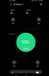

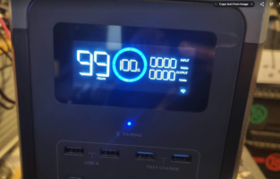

edit:
fully charged.

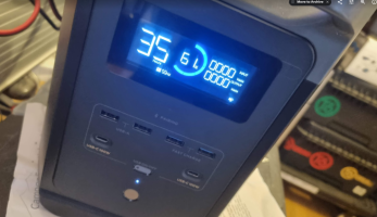

24 hrs later:
61% SoC,
38% drop over 24hrs. with mains inverter ON.
things i noticed:
BT if BT on and APP running you draw more power.
the unit gets warm and fans come on occasionally.
View attachment 197617View attachment 197619View attachment 197618
FWIW ,
when we go camping we use a much smaller inverter to run the fridge's and lights. ( plugged into to the EF 12v socket)
smaller inverter means smaller standby power draw.
but will also add in 12v conversion losses from the internal 48v battery pack.
I came to the same conclusion. I saw 21% over 12 hours. It’s all good to know so now I have set the app to turn it off a lot quicker.
What I need to do is connect something up, my percolator on just the clock or something thats takes some power and see if the app turns off the AC even when something is being used.
